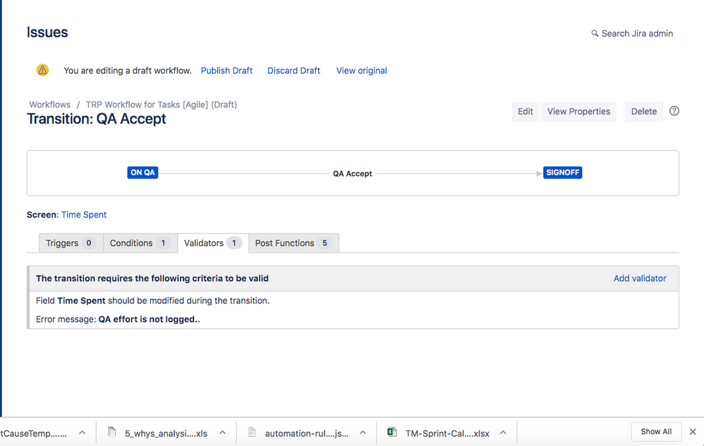

I did add a validator while transitioning from QA->SignOff. I added Field modified validator. It works correctly and shows the alert. However, even if i enter the time log after the alert, the alert or validators still comes into the play. Any insight on why this happens or how to remove this?
i'm not sure i'm following here.
Are you saying that when you transition an issue from QA to SignOff you have a screen that pops up presenting you with the time log and you feel it in and then submit and you get an error telling you to fill in the time? Please provide some screenshots that could illustrate what you are seeing along w/ you transition config and validator screens
Sure. I'm attaching two screenshots. One for the workflow and the other for the validator in place.
The idea is to not allow the user to move the ticket until the time spent is filled in this transition. And if this is filled, the transition should happen.
