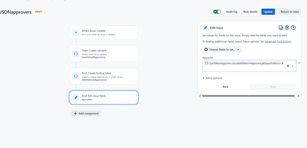

  • edit issue:
    • select the Approvers field and enter this smart value expression
{{varDefaultApprovers.concat(tblPlatformApprovers.get(issue.Platform.value)).split(",")}}

Thanks again @Bill Sheboy for your suggestions. I configured a lookup table with a couple of the Platform custom field so I could test. This field is Single Selection.
I then pasted the smart value for the concat of the three main approvers with the selected value from the table.
On the test tickets I create, I see the three main approvers but have not seen the Platform approvers getting added to the Approvers. My audit is showing success however.

I see now in my original Smart value I missed putting a comma behind the last UserID. By adding that comma it looks to be working. I am going to verify with a few more table values and then mark your answer. You Rock @Bill Sheboy !
