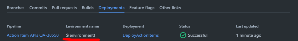

I'm deploying using an azure-pipelines.yml file and the environment name is not getting resolved in Jira:
The yaml looks like this:
variables:
- ${{ if eq(variables['Build.SourceBranch'], 'refs/heads/UAT') }}:
- name: environment
value: UAT
jobs:
- deployment: Deploy
  environment: $(environment)
That variable is resolved properly by Azure DevOps (ADO) as part of the build, but from looking at the webhook call ADO made to the Jira app, it wasn't included. I'm guessing the app looked at my azure-pipelines.yml file and extracted the value directly. But maybe something else happened?
The environment name is UAT and I haven't explicitly mapped it to an environment type; I kind of hoped UAT would already be mapped to Staging. Regardless, I expected the name to still show in Jira correctly.

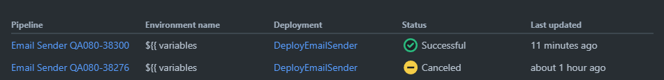

Chelsea Saffold
October 1, 2024
THIS IS NOT FIXED! I have the same issue and have tried the same solution as in the answer and it still prints ${{variables.environment}} as the environment on the deployment modal.
Variables
${{ if contains( variables['Build.DefinitionName'], 'QA' ) }}:
    - nameenvironment
      value'QA'
  - ${{ elseif endsWith( variables['Build.DefinitionName'], 'Develop' ) }}:
    - nameenvironment
      value'Develop'
  - ${{ elseif endsWith( variables['Build.DefinitionName'], 'Staging' ) }}:
    - nameenvironment
      value'Staging'
  - ${{ elseif endsWith( variables['Build.DefinitionName'], 'Production' ) }}:
    - nameenvironment
      value'Production'
  - ${{ else }}:
    - nameenvironment
      value'$(Build.DefinitionName)'
Deployment
deploymentEmailSenderDeploy
    displayNameDeploy Email Sender
    environment${{variables.environment}}
Modal
Carlin Scott October 2, 2024
It seems that template expressions with variables don't work, but parameters do. Conditional insertion also works at the environment input to the deployment job as shown in my solution.

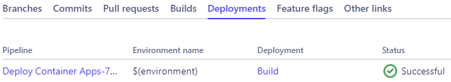

Chelsea Saffold
October 3, 2024
I tried parameters and it didn't work either. It still prints out $(environment) which is not the name of the parameter I am passing, so I'm not sure where that is coming from.
Jira
-VNT-12916-Improve-Jira-Environments-for-Azure-Devops-App-Jira-10-03-2024_04_00_PM.png
YAML
parameters:
  - name: subscription
    type: string
  - name: jobName
    type: string
    default: 'deploy'
  - name: jobDisplayName
    type: string
    default: 'Deploy'
  - name: containerRegistry
    type: string
  - name: repository
    type: string
  - name: appName
    type: string
  - name: tag
    type: string
  - name: deploymentEnvironment
    type: string
jobs:
  - deployment: ${{ parameters.jobName }}
    displayName: ${{ parameters.jobDisplayName }}
    environment: ${{ parameters.deploymentEnvironment }}
    strategy:
      runOnce:
        deploy:
          steps:
          - task: AzureWebAppContainer@1
            displayName: Deploy Image to Function App
            inputs:
              azureSubscription: ${{ parameters.subscription }}
              appName: ${{ parameters.appName }}
              containers: ${{ parameters.containerRegistry }}/${{ parameters.repository }}:${{ parameters.tag }}
Carlin Scott October 3, 2024
Are you passing $(environment) into your template as the environment parameter? The template gets compiled before that variable is resolved in the parent pipeline.
