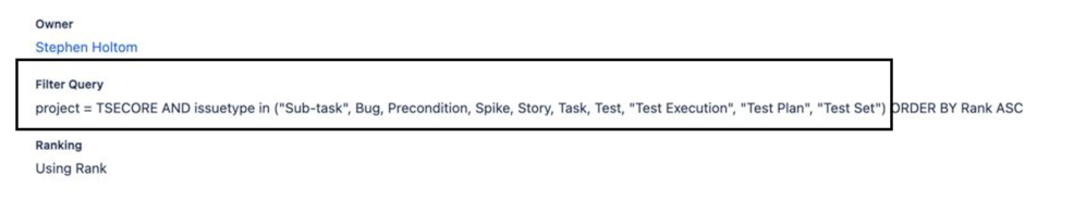

I've saved the filter as "New board filter" (screenshot 1) and epics they are returned once applied (screenshot 2)2EAC1B8E-CFCF-482A-B198-CDEAE62C693B.jpeg
Again, nothing gets reflected in the backlog view>side pane
As requested, I'm also sharing the screenshot of the general tab of my board settings. Thank you for your help.

Hi @Viola Panzeri, no - but now we're getting somewhere: as you can see in your last screenshot, epics are still not returned by the filter behind your board:
Screenshot 2024-04-12 at 14.52.49.png If you replace the board filter with one that does indeed include the epics, you should be fine.
