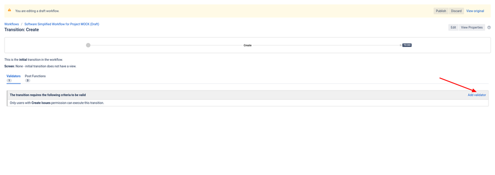

 1. Select the Create transition. Once the dialog appears, click on the Validators link as shown in the screenshot below:-validator_config1.png
2. Once on the validators Post-Function configuration page, click add validator as shown in the screenshot below:-validator_config2.png
3. Select Custom script validator [ScriptRunner] as shown in the screenshot below
4. Finally, add the sample script I provided into the Inline editor and publish the changes.
