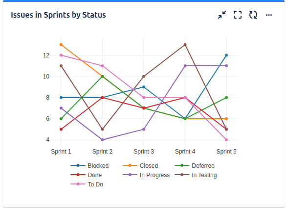

Unfortunately, JIRA doesn't provide this functionality natively. You need 3rd party app for that. You use try the one I developed - Multi-team Scrum Metrics & Retrospective. It doesn't have line graph actually - only bar chart, but it provides a lot of features for the analysis and retrospection. Here is the view you can get with it:
Columns are adjustable. Also, you can track any custom JQL metric here.
