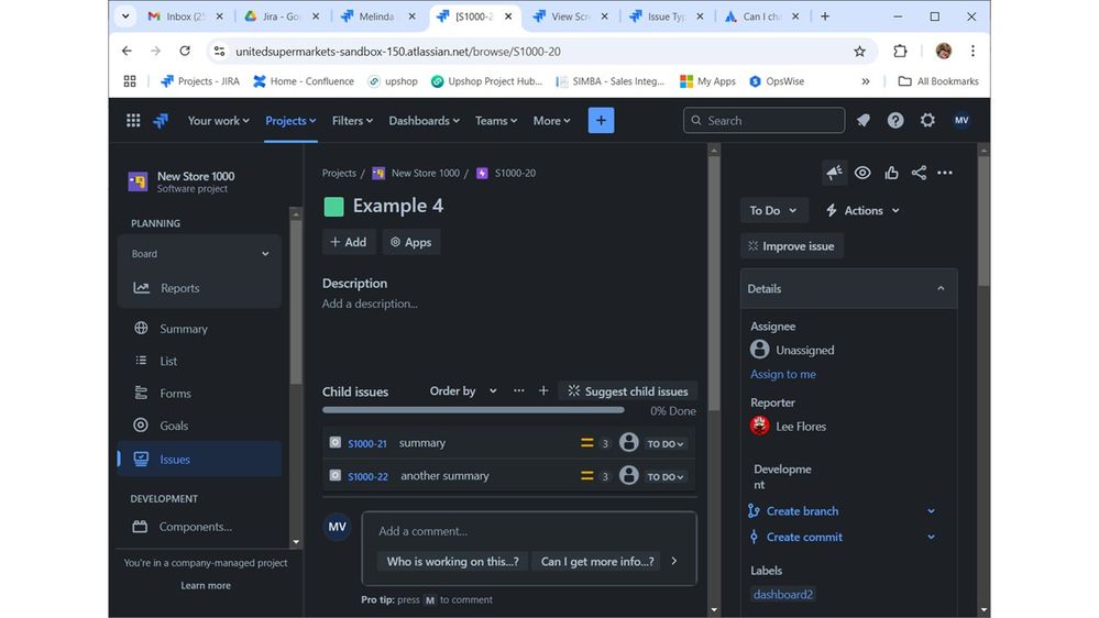

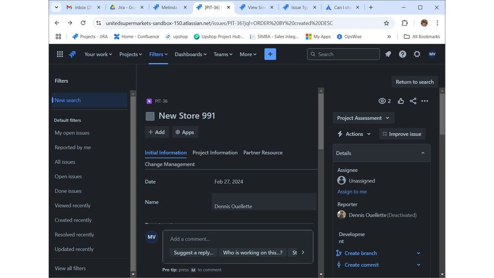

This first screenshot is the old layout. The second is the new layout.
Thank you for that additional information. That is helpful.
I can see that the Epics are in different projects:
S1000 is a Company Managed Software project. That is the old layout.
I can see that the new layout is in the PIT project. What type of project is that? Find it in the list of projects on the View All Projects page under the Projects menu, and tell us what it says in the Type column.
If PIT is also a Company Managed Software project, then it is technically possible to share the screen configuration, fields, and layout between that project and the S1000 project. If PIT is a Team Managed project, then sharing that configuration is not possible.
