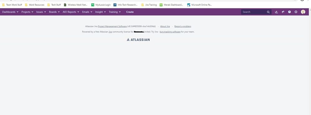

I have set up a new project as a Jira Admin for our PMO and we are trying to configure a new Kanban board (add a few extra columns). When we click on Board/Configure, Jira thinks for a bit and then takes you to a page with the top banner and the Atlassian footer but no options to change anything. Also none of the links from the header will respond when you click on them. We don't get an error message. (see attached screen shot)
I have tested the same on a few existing projects and they all have the same problem. For some reason we can't access the configure board page. Apparent according to other users this has been happening for some time but no one has done anything about it.
Has anyone come across this before? Do you know a fix or where I should be looking to see if there is some weird global configuration setting we have missed.
We are running Jira Server (on-Prem) version 8.5.6Jira configure board error 1.jpg Jira configure board error.jpg
Amanda Culver
March 28, 2022
I had the exact same symptoms.  My own solution was
an admin had imported a workflow from a test instance.
The imported workflow came in with statuses with IDs that were not mapped to statusIds on the LIVE instance.
The workflow itself was erroring, but as the user had edited it on the test instance and not on LIVE, they weren't seeing errors.
The reason why it impacted my *board* was that the filter of my board was searching 221 projects - one of which had this erroring status.  As the board tries to map all statuses from all projects found, this erroring status caused greenhopper (the board to error - silently).
I found this all by tailing the atlassian-jira.log and finding lines like :
2022-03-28 11:55:56,704+0100 https-jsse-nio-10.11.29.9-443-exec-502 WARN user_name 715x14215412x2 1df23w5 ip.address /secure/QueryComponent!Default.jspa [c.a.jira.workflow.AbstractJiraWorkflow] Workflow 'Name of erroring workflow that contains the bad status' contains step 'transition Name' (ID:7) which is linked to non-existing status (ID:12875)
you can also confirm this with a DB query
SELECT wfname   AS workflow_name,
       final.st AS invalid_status_id
FROM  (
      SELECT substring(Cast(matches AS VARCHAR)from '[0-9]+') AS st,
             wstatus.workflowname                             AS wfname
      FROM  (
            SELECT DISTINCT(regexp_matches(descriptor,'jira.status.id\">[0-9]+<','g'))AS matches,
                                                     workflowname
            FROM            jiraworkflows) AS wstatus ) AS final
WHERE  final.st NOT IN (
              SELECT id
              FROM   issuestatus);
Example output :
workflow_name                                                                     | invalid_status_id
Name of erroring workflow that contains the bad status | 12875
