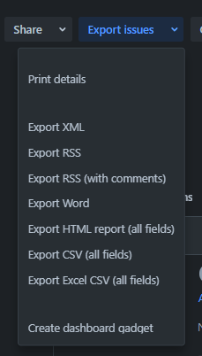

×If I go to Issues, I can apply filters, then click "Export issues" and choose the file format...
That's fine if I want to export all columns, but I generally don't. I usually want to do this when I need to supply a list of outstanding issues to the stakeholders, and all I want in the list are the issue Id, summary, parent and fix version.
Is it possible to restrict the columns exported? At the moment, I'm wasting a lot of time chopping columns out of the exported file.

Yes you can export the required coloumns choose columsn from the System and export as required
thanks for your question. What Jira view do you use to export these issues?
If you go to Filters > View all issues and enter you search query there, you should be able to modify the columns under "my defaults" which is accessible in the export menu:

@Avrohom Yisroel Silver I can confirm, that on my cloud site they are different. When using your way via the issues button you will get the new search experience:
When using my option I do get the old search experience with different entries in the export dropdown which you can see on my first post:

@Avrohom Yisroel Silver as mentioned in my first post, when using the link https://<your-site>.atlassian.net/issues/ the search field will be prefilled with JQL, but you should be able to use the button "Switch to basic" to get the dropdowns for filtering:
Using this view, you should be able to select "Export CSV (my defaults)" with your selection of columns:
