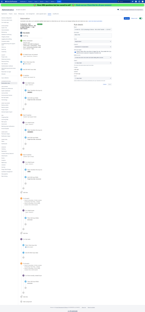

For some context, please post an image of your complete automation rule in one image. You can do that with a screen capture tool, or browser addon which does scrolling page capture. If there are any issue create or edit actions, add separate images for those.

Here is the complete image of the automation rule

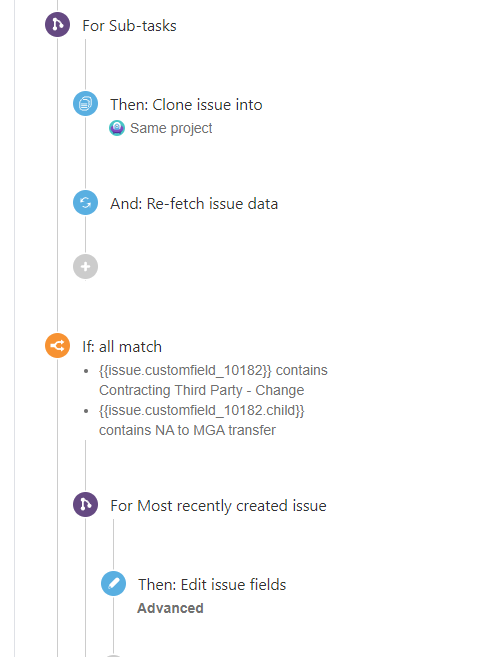

The issue in question is this section: For Sub-tasks
Here are the detail actions

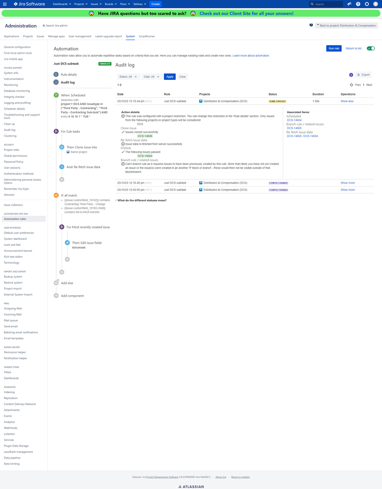

Logs attached.

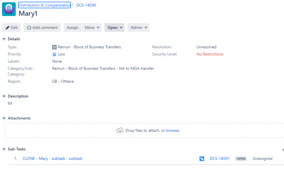

This is the original parent ticket. Issue 14583 created.
Original subtask: DCS-14584
Subtask ticket: 14584

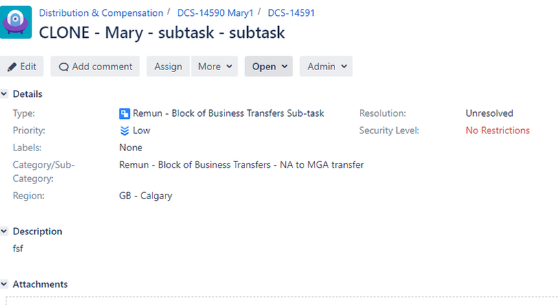

The category / sub-category values should remain as: Third Party - Contracting / NA to MGA Transfer but after cloning the sub-task to the new parent subtask ticket, the 1st level category of the original sub-task ticket got changed from Third Party - Contracting TO: Remun - Block of Business Transfers
This is the clone ticket of the parent: DCS-14590
The clone subtask ticket is: DCS-14591
The values for Category/Sub-Category is correct.

Thank you for all of those details, Mary! That is a complex rule, that I suspect is not working as you intended...due to a couple of things.
First, rule branches which could be on more than one thing (e.g., on linked issues, on subtasks, etc.) are processed in parallel and asynchronously, relative to the rest of the rule. This means that the branch will not complete before the next rule step. Indeed, the branch may not finish up until the last step of the rule.
Your rule contains several such branches, and so that will certainly lead to unpredictable behavior.
Next, when an issue is created inside of an if/else or branch structure, the smart values for the most recently created issues are not reliable, because they happened at another scope. There is a work-around for that for Jira Cloud, but not for Jira Server automation.
My recommendation is to pause and map out what you want this rule to accomplish. That may then require creating multiple rules rather than one large one. Thus one rule may perform an action which leads to the triggering of another rule.
As a start, I recommend splitting your rule by Transfer Type, adding that condition to the JQL, and so you would have multiple, smaller scheduled trigger rules.

Recalling that thing I mentioned about branches, scope, and "most recently created"...your second branch likely cannot work because the rule cannot "see" there was an issue created.
What is happening in that last Edit Issue action?
