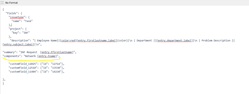

I created a ConfiForms Form were the results are to be used to create a Jira issue using the IFTTT integration rules.
I'm getting error on System field "Component/s" and its a required field in that particular project.
Could someone help me how to describe JSON for that particular field?
Field names are case sensitive!
Components != components
You are also missing a comma after the "TestComponent1"}], <----- comma is missing

How does the complete (jira issue JSON) mapping looks like?
On Confluence/ConfiForms side you have a JSON mapping (in IFTTT macro body)
how does it look like now?
Sorry, but I was asking about the macro body, no macro properties...
Something what you have on your initial screenshot, but current

But setting components in Jira is done differently!
You should really consult the documentation for Jira API - there is nothing to do with ConfiForms here...
"components" : [{"name" : "Network [entry.tname]"}]
(and you had it almost right initially, but then moved to something else - really dont understand why)
Also, in your mapping you have a },} in the end.. WHY do you have a ","? Jira expects a valid JSON to be posted
