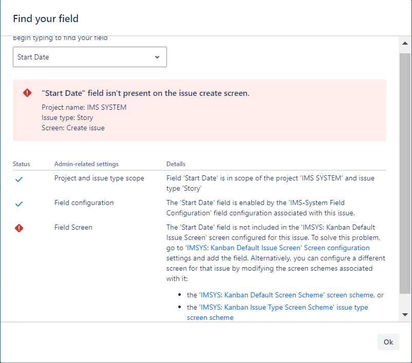

I am receiving this notification for a custom field. Please advise how to remove this field from screen.

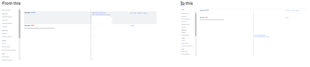

I do change field config, project and issue type scope to another field from
"Start Date" to "Start date".
Because this field is has to be "required" field, but i want to change that to "non required" field (i can't change the option from required to optional because the other field was associated with another screen in another project).

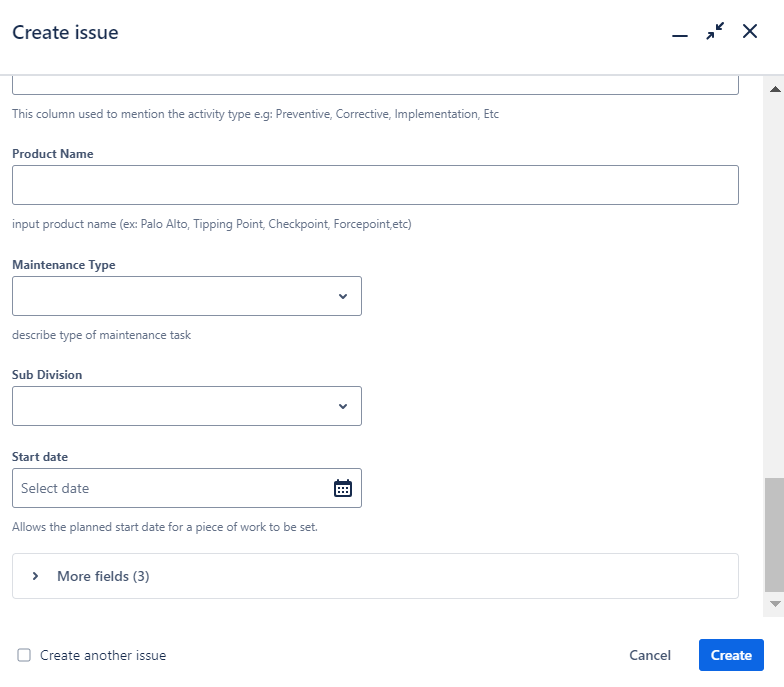

And field "Start date" appeared
But still, i got this notification
Since "Start Date" is required field in the field configuration and is not added to the screen, you are getting the error. If you remove the "Start Date" field from the field configuration, the error should be resolved.
Thanks for reply, but i can't remove the "Start Date" from field configuration, because that field was associated with another screen in another project. I don't want to ruin that
I would suggest creating a copy of the existing field configuration, remove "Start Date" field from it, and assign it to your specific project.

it looks like this might be a different field ("Start date" vs "Start Date"), if you have multiple with same name, try differentiate them by changing name (even temporary) to clear up the mess and simplify a bit.
