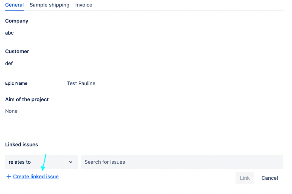

Pauline Hild
September 14, 2022
I just found out that the automation works when I link an issue by clicking "+ create linked issue" but when I use the "search for issues" function to link an issue, it doesn't work. Do you know why this is the case?
John Funk
September 14, 2022
Well, that's just weird. It should process the same way, I would think. Maybe it considers one to be the source and the other to be the destination based on which one you choose. Seems like a bug of inconsistency. I would actually report that to Atlassian.
