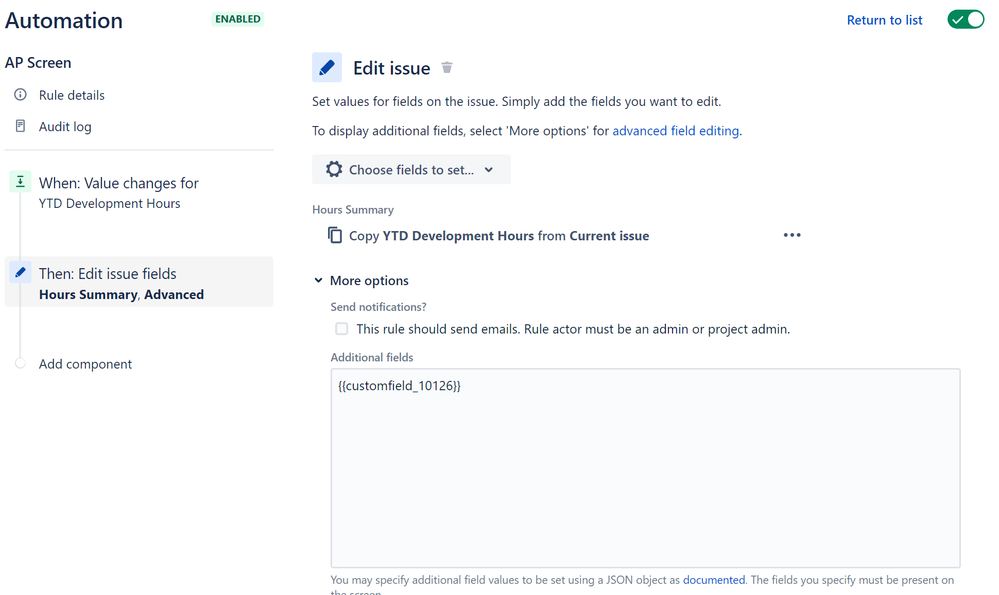

I have one custom field that I need to copy the value of to another custom field. Both fields are numeric.
Its seems the current configuration isnt working.
Copy From: YTD Development Hours (customfield_10126)
Copy To: Hours Summary (customfield_10129)
The Automation rule does not execute with the configuration i've showed. Perhaps I need to add JSON to do this, which I am not very familiar with. Any help would be greatly appreciated.

Hi @Matthew Pears
you can just copy in field with smart values.
For example {{customfield_10126}}.
To find if smart value is right you can check API value with this link :
https://test.atlassian.net/rest/api/3/issue/IT-1
( replace you instance name and your issue key ).

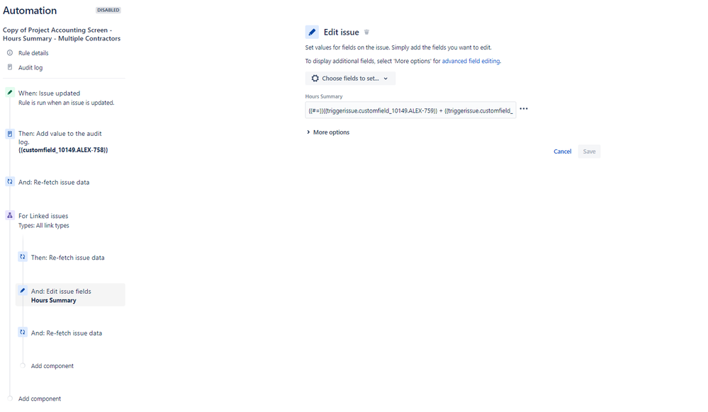

Matthew Pears
March 14, 2022

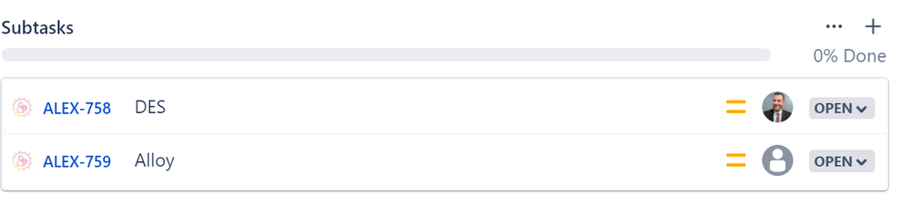

@d.kirsching Hoping you can help me with another problem related to this thread. Here is my scenario.
I have a custom numeric field, Hours Summary, customfield_10129. Its Issue key is ALEX-754.
Then I have another field, Total Hours, customfield_10149, on two different subtasks. Their keys are ALEX-758 and ALEX-759. Of note, the issues are linked to ALEX-754. (Disregard current values)
I want to sum, Total Hours across 758 and 759 and copy them to the Hours Summary field.
I cannot get this to work.
Screenshot 2022-03-14 131515.png Here is the full code: {{#=}}{{triggerissue.customfield_10149.ALEX-759}} + {{triggerissue.customfield_10149.ALEX-758}}{{/}}
Then, I keep getting this error:

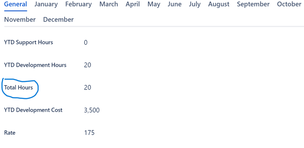

@d.kirsching  OK - we are almost there. The Automation worked perfectly, however we need to make a tweak.
Total Hours (Customfield_10149) is being imputed on two different subtasks. Screenshot 2022-03-14 231626.png
Here are the fields in each of these subtask. The fields are exactly the same.
In short, as the Total Hours value changes, I need their respective Total Hours field summed, and reflected in Hours Summary (customfield_10129), which lives on the parent issue ALEX-754.
See the Parent Image:
As of now, the updated rule will change the value of Hours Summary, but only from one of the subtask that was updated most recently. As opposed to summing Total Hours together from both subtasks, then updating Hours Summary.
Hope this context helps.
