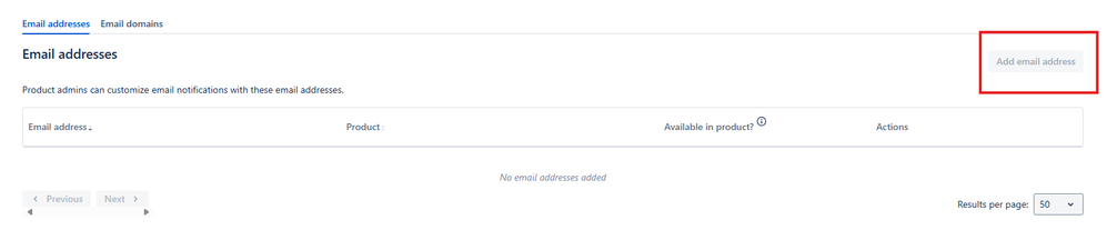

Anna Nguyen
September 29, 2024
Hi @John Funk
Finally I can verify all the DNS records, but why I still could not add the email address, could you please help this step
Dirk Ronsmans
September 29, 2024
@Anna Nguyen ,
Did you first add the domain on the 2nd tab? You'll have to add a domain for the email before you can add the actual email addresses from which you wish to send.
Like # people like this

Anna Nguyen
September 30, 2024
It shows as below image, it has 2 tabs and the email domain is verified
Dirk Ronsmans
September 30, 2024
@Anna Nguyen ,
that should be it though. Reading through the documentation I can't see any specific permissions required. Are you an Org admin? (I assume yes since you can see the email domain details but never hurts to verify).
According to the docs once the domain is verified you should be able to add the email address through that button.
If that remains grayed out and you have the appropriate permissions you might need to raise an issue with Atlassian themselves to have a look at your instance (https://support.atlassian.com/contact)
