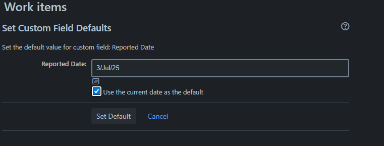

I did try this prior to posting the question.
Here's how it looks. I have a doubt if it will take just 3/Jul/25 for all future issues or if it will take the system date.

hi @darshan_s1 ,
Every time, it will take the default value you have set for each ticket.

Okay, in that yes there are couple of ways..
1. As mentioned by @Ashok Shembde  you can set the default value on the FIELD context but the thing is you can access the same field in other operation like if you want to use the same field for some other project etc then it will set the default value and you can not capture the dynamic date.
2. Using the jira automation --> where you can use the issue created event and you can add the Edit work item action and set the date field default value. example: you can put {{now.format("yyyy-MM-dd")}} smart value.
Like # people like this
Evgenii
July 3, 2025
Voted for that answer, for Automation solution. But with one small remark:
@Yogesh Mude it's not required to use such construction {{now.format("yyyy-MM-dd")}} in Automation rule.
@darshan_s1 is using standard date picker field, so, it will be enough to use {{now}}. It will automatically set Date for date field, or Date + Time for datetime field.

darshan_s1
July 4, 2025
Thanks guys, the global settings - contexts and default values in field configurations helped!!
