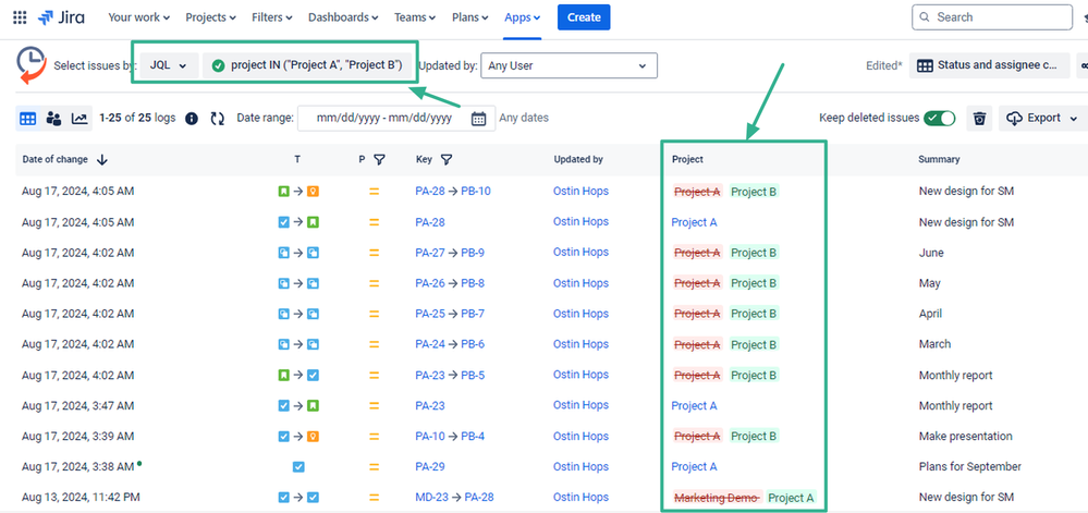

If you are open to using third-party apps, Issue History for Jira, developed by my team, can help with this case.
You can filter several projects with JQL and explore ticket changes in the project field.
