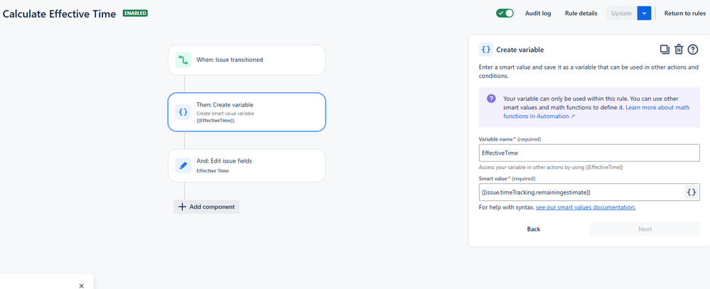

Here is what im trying to do:
I know there is a Worklog option called "Time Remaining" but I cant show that field as a column in the filter, so I created an automation that help me to show that "Time remaining"
This automation works:
But the thing is that I need that field to be constantly updating, everytime that the "Time Tracking" field changes
I tried to set the trigger like this:
But it didnt work, when you change the value for the Time Tracking field, it does not change the "Effective time" field, the automation just ignores it and doesnt do anything
Any Ideas on how can I make this?
