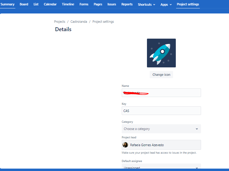

I'm having a problem in understanding the type of Project when one is created.
I created this one a few months ago and my automation works perfectly on it:
Now, I created another one but the automation doesnt work. I think it's because the type of Project is different. Like you can see, the project Settings looks different
How can I discover what type of project (template) I created months ago?
I usually go to the below, but why is first one different?
Rafaela Gomes Azevedo May 8, 2023
I found the problem.
When creating a Project, I was selecting "Team managed" instead of "Company managed". That was it. The Automation is working now

To add to this, maybe it helps: You can always see the project management type in the bottom left corner of the project:
