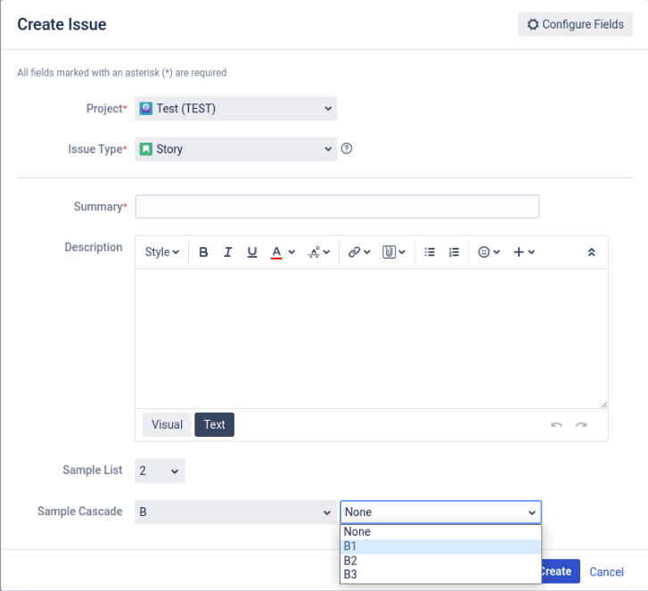

Below is a print screen of the Behaviour configuration:-
Also, I include a few test print screens for your reference:-
1. When I select option 1 from the Sample List, the Sample Cascade list is filtered to only option A and its child list will only show the options A1, A2 and A3, as shown in the print screens below:-
2. When I select option 2 from the Sample List, the Sample Cascade list is filtered to only option B, and its child list will only show the options B1, B2 and B3 as shown in the print screens below:-
