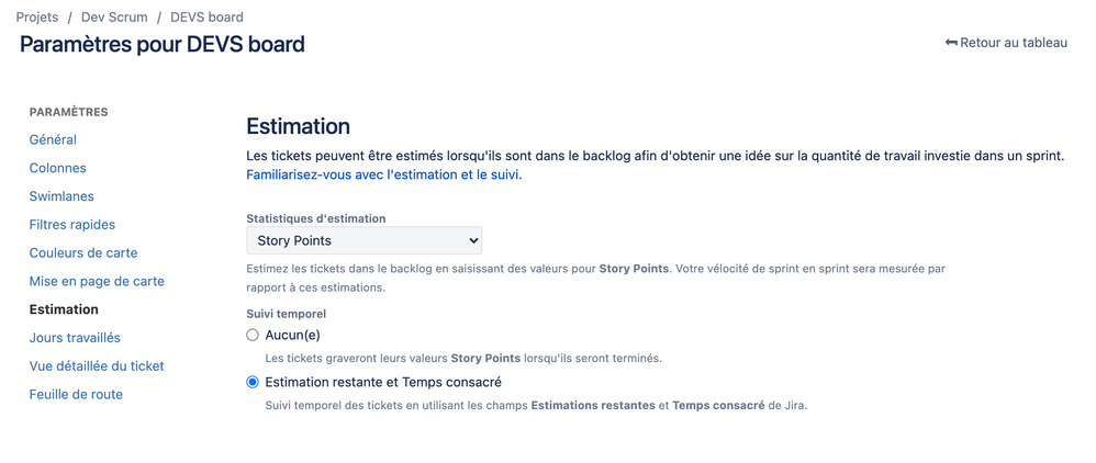

Hello @Claus Østergaard Pedersen ,
Indeed that's a though one, you can try using the "Burndown Chart" gadget from a dashboard;
Then, you would have to go to your board settings, in the "Estimation" parameters and select the "Remaining estimate and ... " option :
Then your burndown chart should decrease depending on the remaining estimate, hence you'll be able to know the total remaining estimate of the sprint i guess.
Let me know how it goes,
Guilhem

Hi Guilhem,
First off all, thanks a lot for your quick reply!
I tried what you suggested, and I can now see the total Remaining Estimate for the sprint in the Sprint Burndown Gadget on my dashboard.
I do wish there was alternative ways to get this information, so that you wouldn't have to "eyeball" it from a chart, as this exercise gets increasingly difficult if the scope of the sprint is changed when the sprint is active.
It would be nice if you could ad a sum total in, lets say, the filter results gadget in Dashboards.
