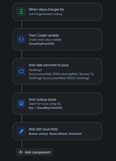

This is a flow of my new automation function:
In event log I get a success status, but fileds don't complement each other according to automation.
Comment who I add look like
And result
 Example of a value from customfield_10353 is in TestString2
Is there an error in my thinking somewhere here?
It seems to me that the function {{issue.customfield_10353.substringAfter("/browse/")}} should only return “DEW-1302” and then this should be retrieved by automation

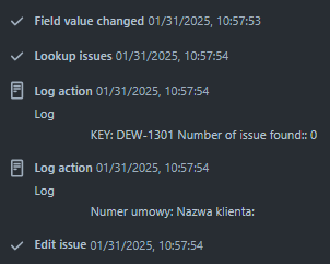

Patryk Kowalczyk January 31, 2025
Thank you for your advice.
I added the audit log action to my automation and got interesting findings.
The problem is not with the smart value, but with the search function.
The automation cannot find any problem with my key.Zrzut ekranu 2025-01-31 110615.png
I added permissions for the jira automation user to the project where the issue being searched is, but it still doesn't work.
(The issue being searched for is in a different project than the trigger issue).
Additionally, I tried adding “PROJECT IN(”DEW")” to my JQL issue search, but the effect is the same.
Maybe I should use another function to search for the problem in another project?
The rule is configured for a specific project and gives the automation user permissions to another project, which is a potential search
Jack Brickey
January 31, 2025
Understand but it may be that, in order to reference an issue in another project the rule needs to be multi-project. I have never tried this previously. Can you try this? Alternatively as a test try referencing an issue in the same project.
Like # people like this
Patryk Kowalczyk February 3, 2025
@Jack Brickey
You are right!
When I change the automation scope to global, it starts working fine!

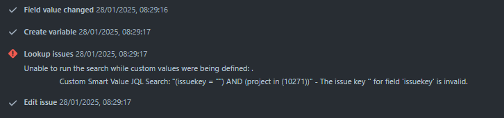

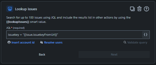

Second version with new created variable:
And here i get errors "Unable to run the search while custom values were being defined: ."
Probably variable don't have value but i don't know why
