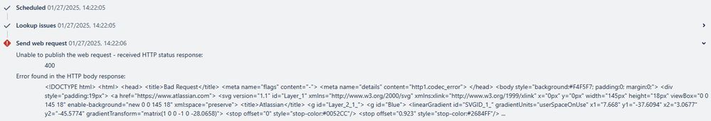

When starting, it writes errors in the log:

Hi @Лёня Криволапов -- Welcome to the Atlassian Community!
The rule you show has
  • a Scheduled Trigger (likely without any JQL)
  • a Lookup Issues action
  • a Send Web Request, trying to reference {{issue.key}}
But there is no issue available to use, only the results of the lookup, and so the URL for the request does not work.
And...the reason you cannot see the Log Work action is the same reason: it is currently displaying the Compatible actions, and without an issue that is not compatible.
There are two ways to solve this:
  1. remove the Lookup Issues action and add the JQL to the trigger, using the Log Work action to add the time
  2. remove the Lookup Issue action and add the JQL to a Branch on JQL, using the Log Work action
