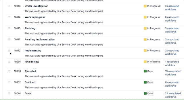

Hi Swetha,
this is easy to solve. Head over to the Statuses section in your administration and bring them in the correct order, so start with the status category first. If you have tons of statuses this can be tedious work - been there, done that. 😁You might want to have a look at this little helper on the marketplace Admin Toolbox for Jira we developed, it enables drag & drop sorting for different system entities. 😁
Best, Max
