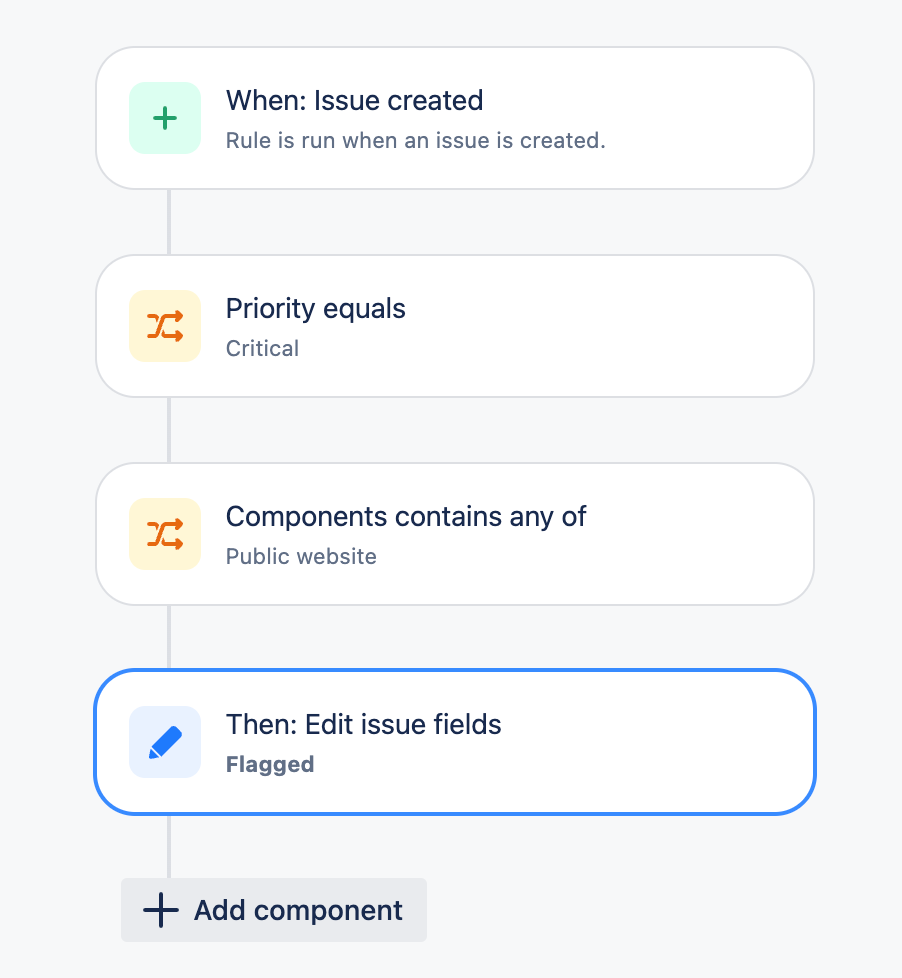

In regards to automation, I think the best trigger that you could use here is "Issue Creation". Then, you can configure Jira automation to take into account the value of a fields, or several fields to determine if the ticket could be flag or not.
Finally, add action to flag the ticket, as can be seen in the screenshot below:

Hi @Sherwin Soriano
Yes, that is possible using the issue created trigger, a condition to check the issue type, and then setting the Flagged field, however...
What problem are you trying to solve?  That is, "why do this?"
Issue flagging is typically used to indicate something, such as an impediment blocking work.  And so immediately flagging an issue when it is created seems quite unusual.
