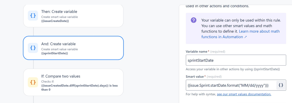

Bruno Leite Cervantes July 10, 2024
Hi @Mikael Sandberg ! Yup, I did and still doesn't work. Here's the screenshot with the issue created date and the sprint start date. Even if I use jiraDate, the "diff" function isn't working when I try to compare the dates.

Trudy Claspill
July 9, 2024
Hello @Bruno Leite Cervantes
When asking for help with an Automation Rule, it is vital that you share with us screen images showing the complete rule and the details of each step. Obscure confidential information. It is also helpful if you share with us the details in the Audit Log generated when the rule ran.
Thanks for the advice @Trudy Claspill . Here are the screenshots. The last screenshot is the date written in the comment field after the automation ran.
image.png image (1).png image (2).png image (3).png image (4).png image (5).png
Trudy Claspill
July 10, 2024
Why are you creating variables and then using the variables in your comparison? You can simply use the smart values you used to create the variables.
{{issue.created.diff(issue.Sprint.startDate).days}}
When you create Variables the values are stored as text. The "diff" function can be used only with smart values that are Date or Date/Time types.
I think if you use the Log action to print out the smart value you were using with the Variables you will find you are not getting the answer you expect. But if you simply use the original issue smart values then you will get closer.
The diff function can return a positive or negative number. I recall that depends on how the date fields are referenced, but I never remember which way to go. So you might want to use a Log action to print out the above value also to check if it is returning a positive or negative number as you expect.
