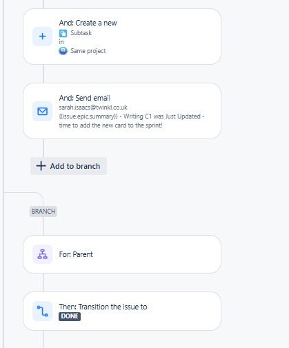

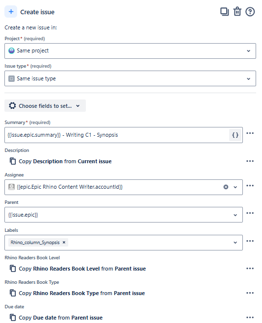

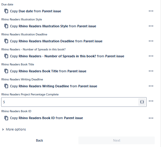

I have created an automation that creates a task and sub task once the first task (original task has been completed (done). See Images below. I'd like to add to this automation to only create the task (and its sub tasks) if it doesn't already exist. Is that possible please? Can you help?

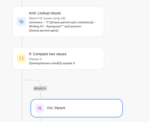

Assuming that is correct I recommend that you insert a Lookup Issue action to see if an issue exists that matches the criteria of having the same Summary as the new issue you would create and is a child of the Epic.
Then check if the results of that Lookup is no issues being found.
If no issues are found the rule will proceed into the branch and create the issue.
Let me know if you need a more detailed explanation.

Thanks for the reply, I super appreciate it.  I just wanted to thank you as this worked a treat.  I had to use this instead: {{smart values}} condition. As I didn't have Advanced Compare. You may have meant that. Thank you

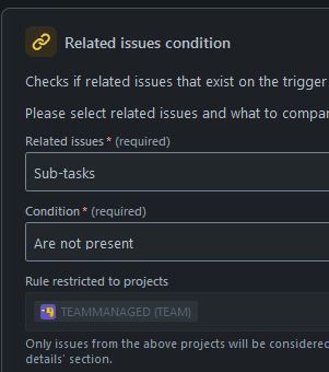

Can you add this check after the issue type condition?
2025-01-03 10_28_12-Rule builder - Automation - TEAMMANAGED - Jira — Mozilla Firefox.jpg
This should check if a sub-task exists. If it does, then continue with the next actions.
