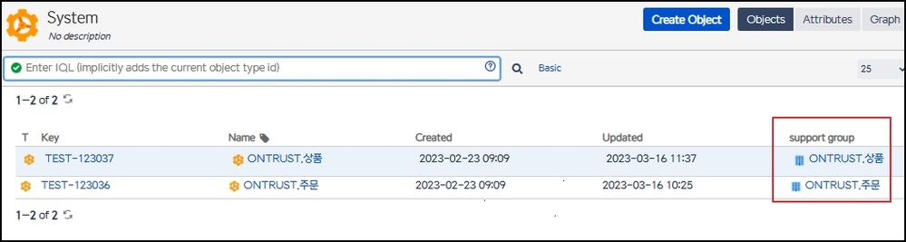

I made enm_system custom field referring to system object field. However I can't search created issue with enm_system custom field.

I tried several ways. How should I do?
 project = ENMCOMITSM AND ENM_System in iqlFunction("System.\"Name\" = \"ONTRUST.주문\"")
project = ENMCOMITSM AND ENM_System in iqlFunction("Name = ONTRUST.주문")
project = ENMCOMITSM AND ENM_System in iqlFunction("Object HAVING outboundReferences(Name = \"ONTRUST.주문\")")
