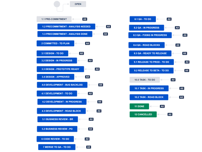

I have created a workflow without transitions (see attached - I want to allow to move from/to any status without restriction). In this workflow, I have marked a few statuses with type = Done (i.e. they appear in green).
My problem is that when issues are moved to the "Done" status, this does not mark the issue as "resolved" and does not set the resolved date.
Is there a way to mark issues as "Resolved" without implementing transitions?
Alternatively, is there a "date when the issue was marked as done" so that I can filter out old issues in my Kanban boards ?Kanban workflow.png

On the “All” transition for closed you need to make to post function to set the resolution to done, completed, or whatever you wanna use.
