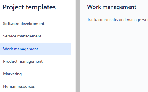

I'm not completely certain about "FREE" Product Plan, but if you go to create a project, do you see "Work Management" as an option in the Project templates?
If so, you can go ahead and create/experiment.

This is exactly the information I was looking for. I took a quick look into our system and we are able to use work management templates. So we are going to give it a try.
