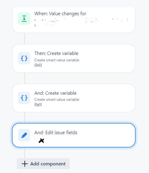

Option1 - Solution I have tried (didn't work):
  1. Created B as a field in Task
  2. Automated (A+B) and stored as variable x -  {{customfield_12345.Plus(customfield_23456)}}
  3. then x is divided by C and stored as variable y - {{x.divide(customfield_34567)}}
  4. display y in field X {{y}}
The rule run successfully. But no output as such.

Hi @Sreelal CS
Created variables are text strings and so they usually need to be converted to numbers for use in math expressions: https://support.atlassian.com/cloud-automation/docs/jira-smart-values-text-fields/#asNumber
For your example of a variable named "x" divided by a number custom field, customfield_34567:
{{x.asNumber.divide(customfield_34567)}}
