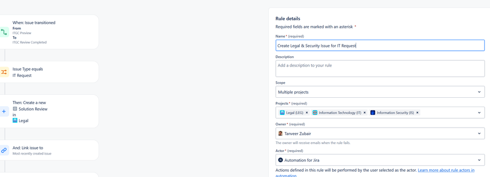

Tanveer Zubair March 19, 2025
Hi Bill,
   First thanks to look into it.
It is multiple projects.  Here is the details.
March 19, 2025
Ah, you are trying to relate the newly created issues to each other also.
To do that, you could use the plural {{createdIssues}} smart value: https://support.atlassian.com/cloud-automation/docs/jira-smart-values-issues/#--createdIssues--
Let's assume you are adding two issues, and want to link the second one to the first one.  The relevant parts of the rule would be:
  • action: create issue
    • in the issue create, add a link to the issue with:
      •  {{createdIssues.get(0)}}
This uses the list function get() which is 0-based for the first item.
Tanveer Zubair March 24, 2025
Hi Bill,
   Thanks for your suggestion.  It make sense.  It does work.
