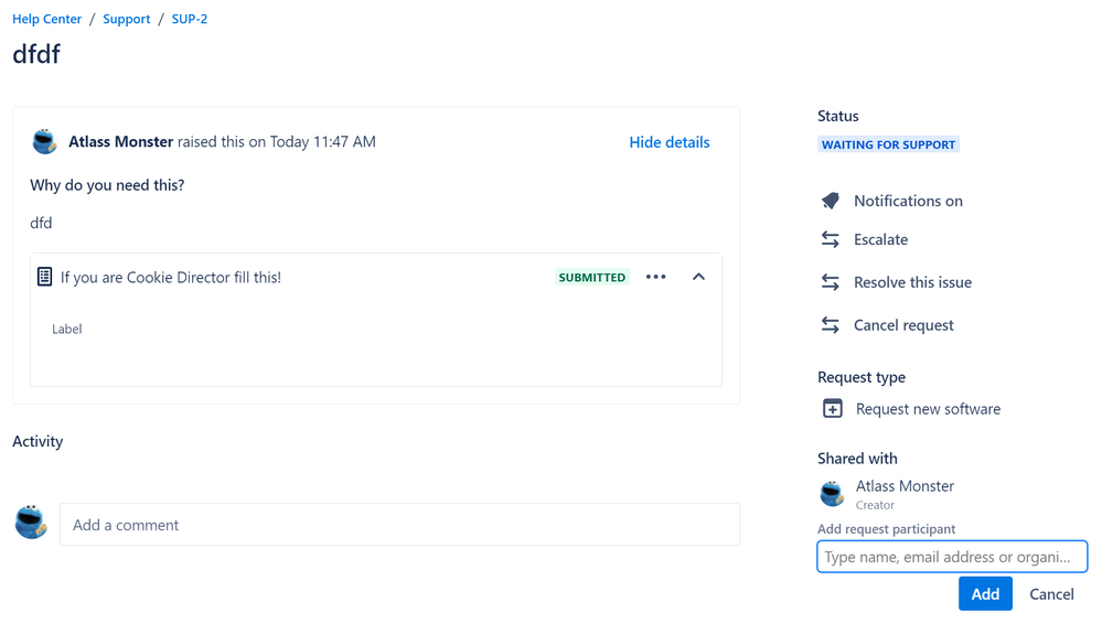

Example flow of directoring...
1. I'm user or client and I make a request.
2. The Assignee will add the Director as participant or your can Automate it on request created...
3. The Director will see that there is a Form that allow you to input a value or select one from a drop down (drop down is better!)
4. The Form is configured to set a custom field value that is visible on the issue screen for the Assignee later on.

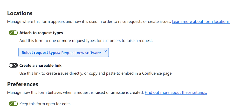

Here is how I made it work, your step could be (as should be) different than mine:
1. Make a new form and attach it to a Request type/s
2. Make sure the Director is added as participant
3. Tell the Director what they need to do
4. They will see this
I have edited the form setting to keep it open for edits
5. Profit! No wait, there is nothing to profit we are not Ferengi.
I suggest you add yourself as participant and test the flow yourself first it work for me but my Portal settings are stock.
