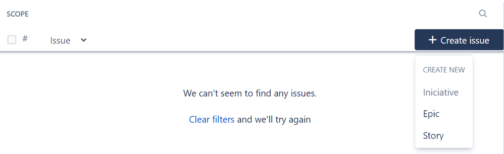

I am actually interested on learning how to add up Issues on a release version through Advanced Roadmaps only. In your last reply, you explained how to updated releases by editing Issues that are already set up on the version. I haven't noticed features on Advanced Roadmaps that enable new issues' picking from the respective project, only a button for Issue creation.create.png

As your screenshot shows: you don't have any issues in your screen. So you can't select any (obviously).

As I previously stated, my team and I have decided against using Backlog view in our Jira project board, so I am mapping alternative approaches to create versions. Formerly in this post, you drew my attention to the fact that I could add Issues in bulk to Releases using Advanced Roadmaps. Since then, I've been attempting to figure it out but so far all I've found is that we are unable to directly add Issues to a version using Advanced Roadmaps;
As I tried to demonstrate before with that screenshot, it looks that using Advanced Roadmaps, we can only add NEW Issues directly to a version as well as EDIT Issues that have already been added, is that correct?
