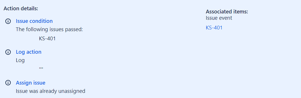

Yousuf Al Rawahi
May 27, 2024
The automation status is successful, but it is not assigned, it says 'Issue was already unassigned'
Sayed Bares [ServiceRocket]
May 28, 2024
@Yousuf Al Rawahi your query in the lookup object is wrong, it should be something similar to
 Name like "{{issue.Resignee.name}}"
If it doesnt work what is the output of
Name like "{{issue.Resignee.name}}"  if added in a log action? is Yousif Al Rawahi  object under IT assets? Can you share a screen shot from Resignee custom field configuration?
Yousuf Al Rawahi
May 28, 2024
In the log action it displays as my name.
It still doesn't work, it says 'Issue was already unassigned' when assigning an issue.

Yousuf Al Rawahi
May 28, 2024
What is the purpose of adding Name Like in lookup objects?
I have used {{lookupObjects.Manager}} in log action, it gives me and empty result. It could be an issue from {{lookupObjects.Manager}}.
