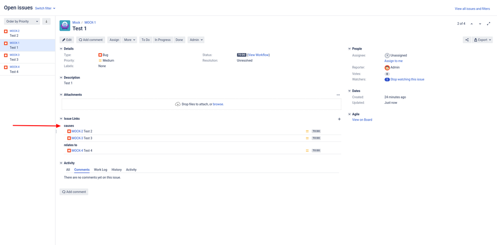

Below are a few test screenshots for your reference:-
1. First, when the ticket is created, two types of Issue Links are added, i.e. causes and relates to.
2. Upon running the code in the ScripRunner Console, as expected, only the cases link has been removed, and the relates to link is still retained.
