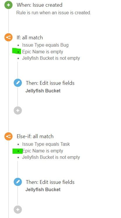

Nauman Ahmed August 23, 2022 edited
@Sam Nadarajan  / @Mark Segall : guys thanks for pointing me in the correct direction, i've managed to create an automation rule - there is only one issue
The EPIC LINK field is not available for automation rules, it does not show in the list of available values and i learned that it used to be available but then it was removed.
In the picture uploaded - the highlighted field should be EPIC LINK - is there any way to get that in automation rule?
