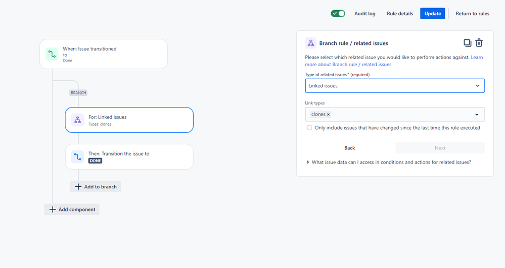

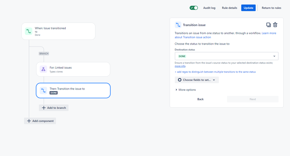

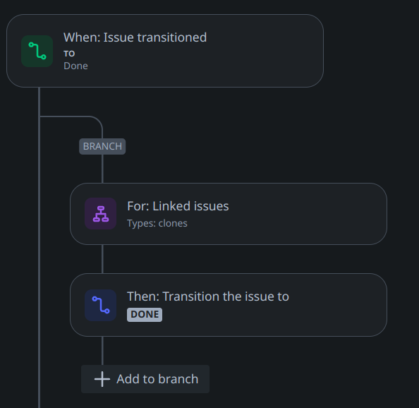

Hi
You can try using the following automation.
This automation operates by checking for linked issue types when a ticket is transitioned to the "done" column. If the linked issue type is "clones," it will then move the parent issue to the "done" column.

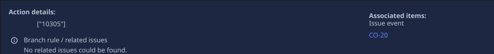

Jamshaid
February 14, 2024
@Jerrold - Empyra Thanks for responding. I have tried this and it does not work.
Here is the result

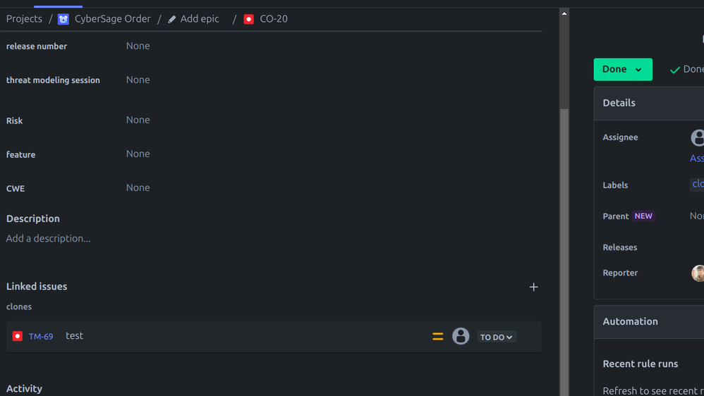

Here is the relevant issue
Could you please guide what's wrong on my side? I am an admin in both projects.
