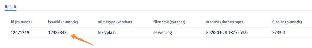

@Abhijeet Kale You can try the below steps to get the issue-key from attachment id
  • Identify the issue-id from the attachment-id from the database
SELECT * FROM fileattachment where id = '12471219'
You will get an issue-id from the query result like below
Then find the issue-key using issue-id, you will get the details as shown in screenshot below
https://<basr-url>/rest/api/2/issue/12929342/
Let me know in case of any issues.
Abhijeet Kale June 7, 2021
Thanks @Sagar Mahajan I am able to get the issue-key from attachment id from above steps.
