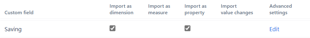

How to import a custom field as measure in eazybi?

Save the changes then go to the same screen shown on your screenshot and tick the "import as measure" and do a data import.

I have tried this before and I have tried again now, it doesn't appear the checkbox for measure. Any reason why?
I posted an answer above as well - for some field types it not possible to import the field as a measure, for example a - a text field. Only numerical values can be imported as a measure. Please share your use case regarding what you would like to achieve with your report and we can help you come up with either an MDX or custom JavaScript code.
If your field is a text/string type but you only have numeric values in the text field, you can read more about a solution how to import the field as a measure here (it would require changing the field to numeric) - https://community.eazybi.com/t/is-it-possible-to-convert-a-jira-custom-field-type-string-to-integer-to-become-a-measure/8003
