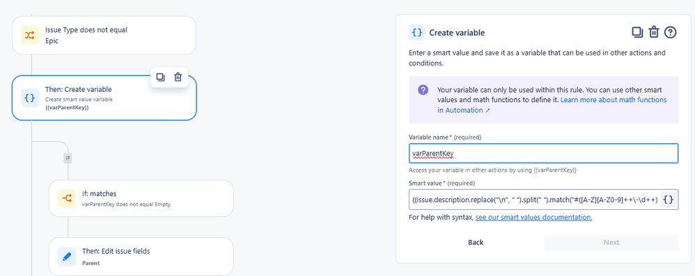

hi Bill, thanks for your effort ! here is my automation in screens. I like your code, but do not know how to use variable in automation
March 22, 2025
That expression may be used with the Create Variable action near the beginning of your rule: https://support.atlassian.com/cloud-automation/docs/jira-automation-actions/#Create-variable
With that, the resulting smart value could be used as the parent key.  For example, if the name used in the variable action was varParentKey the parent could be set to {{varParentKey}}

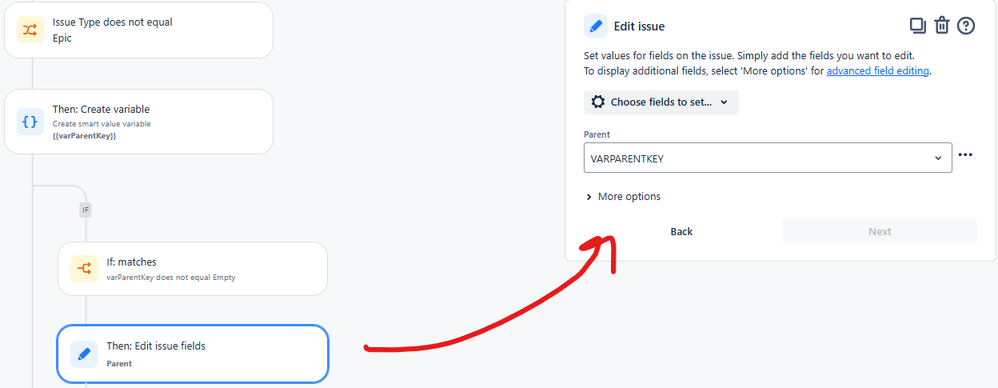

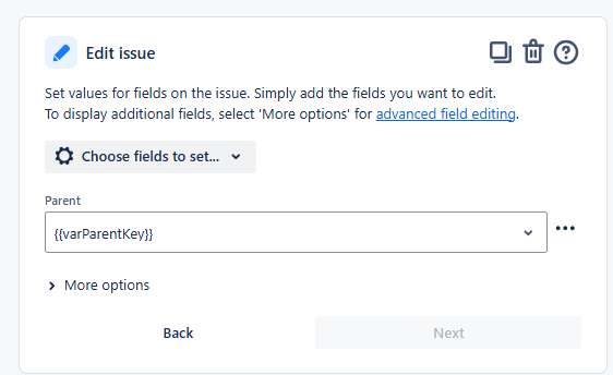

that's helping me to understand the point, thanks Bill . what I miss in this is , how to set Parent with variable. Shall I use "Edit Issue Filed" select Parent ... or some other way ?
Juraj March 22, 2025

oh yes, I found error. variable should be written with brackets... and now it works perfect!!! thanks Bill so muchpic7.png
