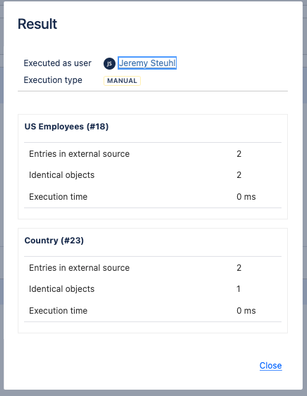

After I execute, this is the message I get:
Which is strange, because the 2 country names in my file, already exist in the country object, exactly, yet it looks like only 1 was listed as an identical object.  I checked and there aren't any new records created in the country object, so maybe I don't understand the output on that.
