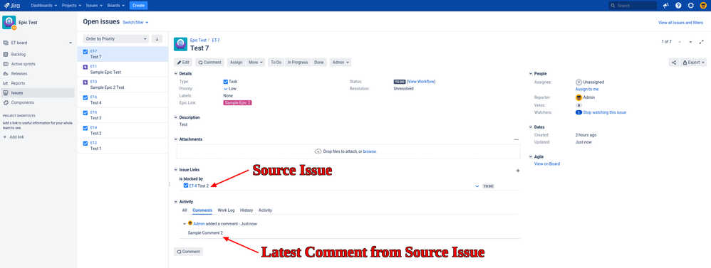

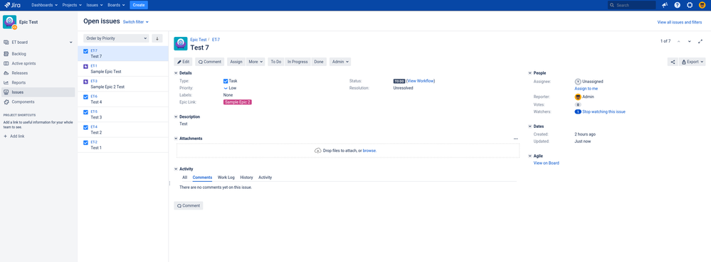

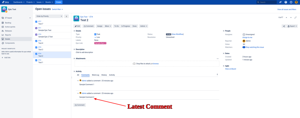

1) The destination issue before it is linked to the source issue:-
2) The source issue, with the comments:-
3) The destination issue after it is linked to the source issue with only the latest comment from the source issue:-
