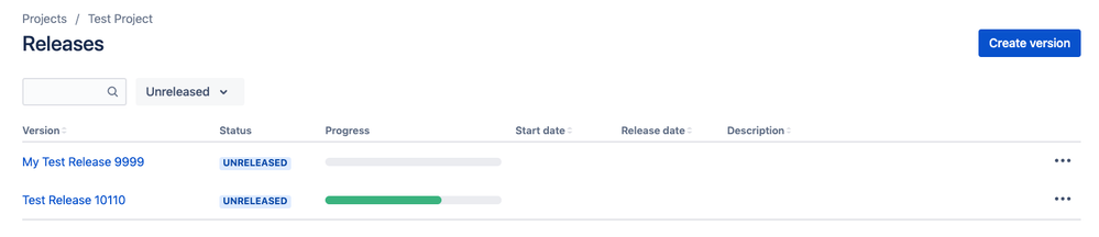

I thought this would be the case, however, when I was testing in my sandbox project I found that if there were multiple unreleased versions in the Releases table "Next unreleased version" would always select the version at the most-bottom row.
In the image below, a newly created ticket would always get tagged with the "Test Release 10110" version instead of "My Test Release 9999".
Screen Shot 2020-12-18 at 7.11.42 AM.pngNonetheless, thank you very much for replying and ultimately solving my problem!
