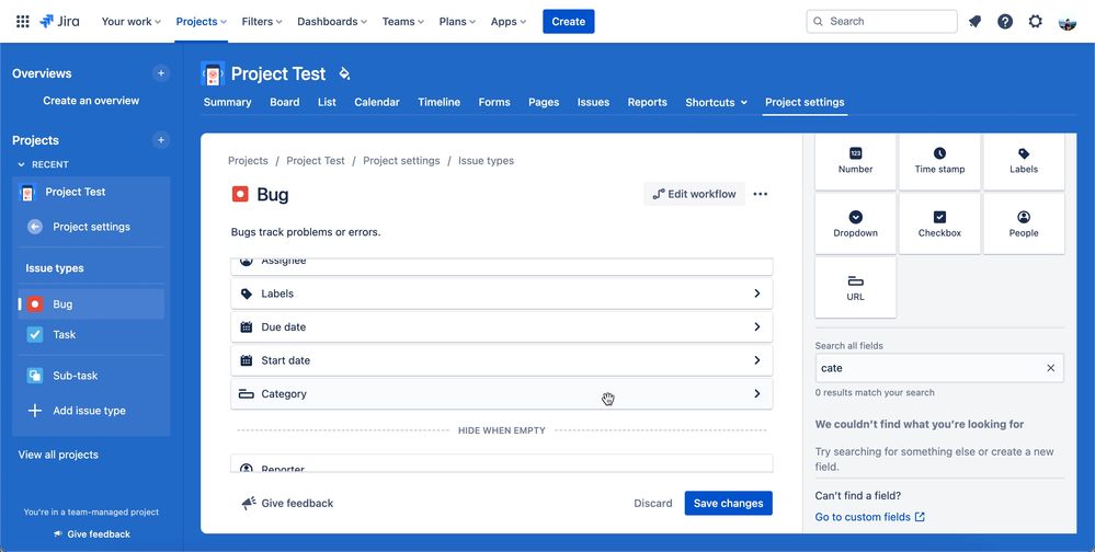

@Hazha.ahmed is this happening to a specific issue types? if so have you added the category field to those issuetypes? you can check this by going to your project settings > find to the issue type in which you can't set up the category field > see if category field is added:
Hazha.ahmed
July 11, 2023
@Sayed Bares _ServiceRocket_ Thank you very much. That is exactly the answer :)
It worked
