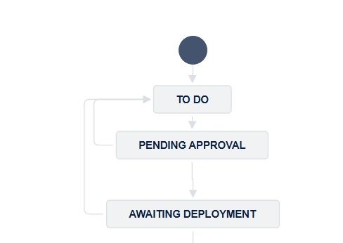

This is the very simple workflow in question
In order to execute the transition between PENDING APPROVAL and AWAITING DEPLOYMENT, I have the following transition itself is very simple and has no other conditions or validators which would be causing a clash or issue

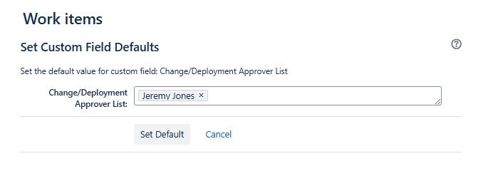

This is the Group Field listed in the above 2 screenshots
This is the context for the custom field

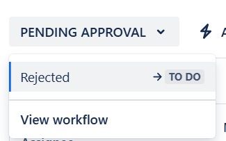

And these are the only options available when attempting to transition the issue

When the condition is set to "user is in field" and you see only these options:
What value(s) are shown in the Change/Deployment Approver List field for that same field?

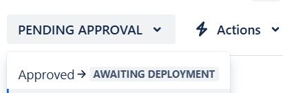

If I manually add myself in the field in the ticket, then I get the approval option

I see that in the context you set a Default Value for the field as "Jeremy Jones". The default value will be set only for new issues create after you specified that default value in the context. Was the issue you were trying to transition created after you set the field context to specify "Jeremey Jones" as the default value.
As to why you are seeing all users, when you click the pull-down option you would be shown a list of users that are valid to select for that field. That would be based on the context that you set for the field, and specifically the User Filtering setting of that context.
Since you have that set to "All active users are allowed", when you use the field pull-down to get a list of selectable values for the field then you will see all valid/active users of the Jira instance.
