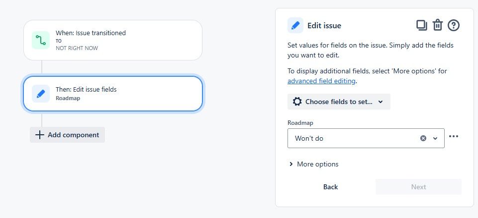

I'd like to create automation so that when a ticket is transitioned to a certain status, a certain field option is populated.

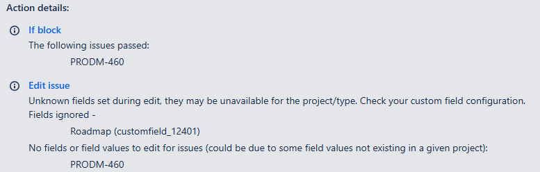

I receive a failure message that there are unknown or no fields set

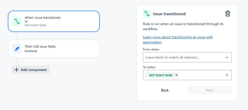

I have tried When Issue is transitioned to..(certain status)
and Then Edit issue Fields (and selected the relevant field and option) but it does not work.

Here are 2 images of the 2-step automation rules I created;
I receive the following audit log error
This is the following issue message i receive in audit log

Have you checked if there are other fields named Roadmap in your site, and the rule is possibly trying to update the wrong one? Your Jira Site Admin can help check that.
You could use this how-to article with an example issue, such as PRODM-460, to confirm the rule is trying to update the correct field: https://support.atlassian.com/cloud-automation/docs/find-the-smart-value-for-a-field/
The essential steps are to lookup the issues fields using a browser tab to call the REST API, and then search for your field on the page, such as with CNTRL-F.
The audit log shows the rule trying to update customfield_12401, so compare that to what you see.
thanks. After some investigation I've finally discovered the issue... I needed to have myself assigned as 'actor' in the actor field, rather than 'automation for Jira' being assigned, so there was a licenced Jira user associated to the automation.
That makes sense as JPD requires the user to have Creator permissions to make most changes.
Which user was the actor originally?
Yes, I believe that is a known problem / behavior with the built-in Automation for Jira user and JPD projects...the built-in user normally has enough elevated permissions to do anything, but not for always for JPD.
