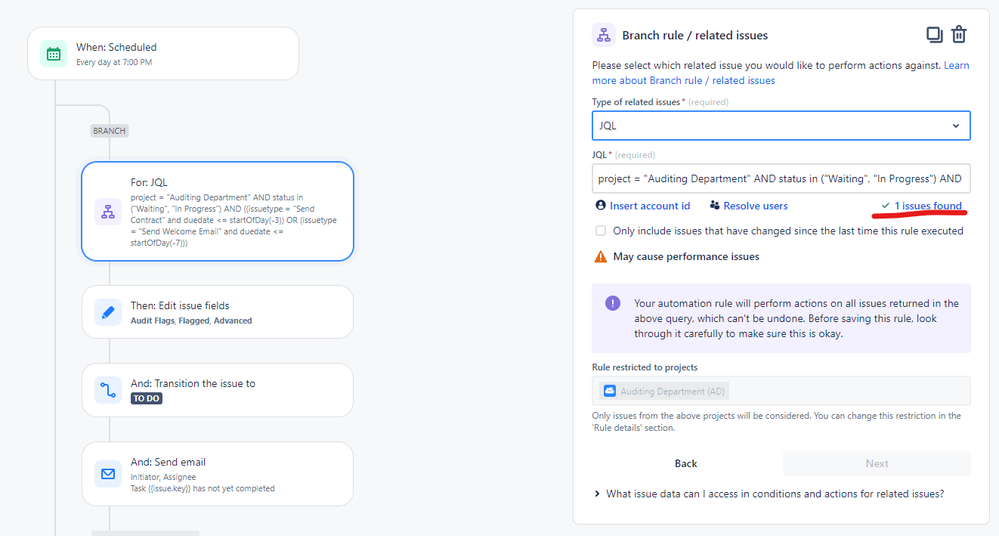

I have an issue where JQL branch automation is not finding the issue.
When I run the JQL in a filter it is returning data.
When I validate in the automation module (after adding the JQL condition, there is a validate link which shows that it found data), however when the automation runs it is not finding any data.
Any help on this?

See below rule (note the validate issue link shows that 1 issue found).  Also see below, the exact same query (copy and paste) runs and shows an issue.
Yet, when the automation runs it does not find this issue.
Also note, that I had a different issue type and the query finds both issues, however when the automation is running, it is consistently not finding the same issue (that is shown below).
Raphi Levine
February 27, 2024
I should note, that I have tried testing changing the query to only find items in the specific status (no other JQL statements included) and even though the filter returns data, when the automation is run, it is not finding this task.
