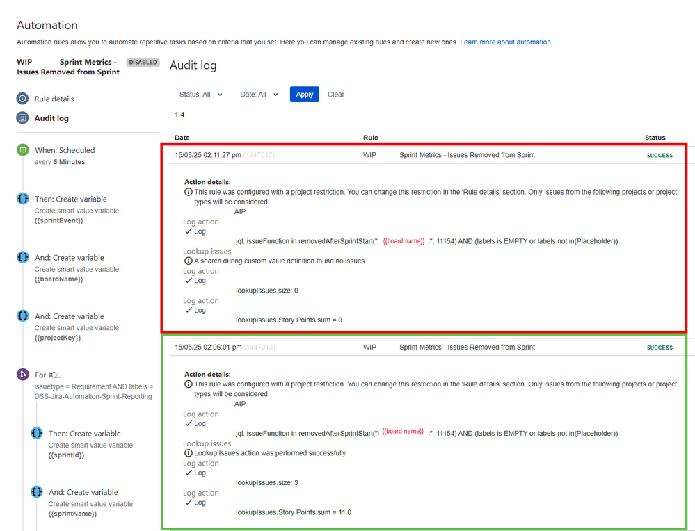

Problem Statement:
No results are found when using a JQL function in a Jira automation AND the automation is either automatically triggered (e.g., sprint close) or scheduled. However, the same JQL returns results when manually triggering the automation.
The following screen shot shows the audit log; the green section shows results when manually triggered. The red section shows the same automation after being scheduled.
JQL in Automation.png Additional Background:
The objective of the automation is to identify sprint changes; tickets and story points added / removed from a sprint. There is a similar automation exists that uses the addedAfterSprintStart function, instead of removedAfterSprintStart.
FYI - variables (e.g., sprintEvent, boardName) are used so the automations can be used in different projects by updating these "configurations". Since the automation is scheduled, the automation doesn't have access to Sprint smart values. The For JQL block is selecting a specific issue that contains the Sprint details.

Steve Tedeschi
May 16, 2025
I thought this maybe a factor because the filter for the board can include issues from other projects (all issues from the other project are resolved). I tried 'duplicating' the board with an amended filter for just my project without success.
If project scope were a factor, I would think the JQL would return also return no results when manually triggered.

Until we see those, please note there is an open defect for using ScriptRunner functions in JQL with a scheduled trigger rule: https://jira.atlassian.com/browse/JIRAAUTOSERVER-1095
Steve Tedeschi
May 16, 2025
@Bill Sheboy - Thanks for feedback... trying to tackle your questions in order.... let me know if I miss anything
Please let me know how best to request additional help on an existing post.
Please see full screenshot below. The "worked" run was manually triggered and is highlighted in green. The "failed" run was scheduled.
I think you're right and my issue is related to JIRAAUTOSERVER-1095. That Issue mentions the same functions I am using. Do you know if the issue is limited to those or all issue functions (e.g., portfolioChildrenOf are also problematic)?
May 17, 2025
Starting with the original symptom, that defect does seem to be the problem.  I suggest contacting the vendor for ScriptRunner or Atlassian to learn which functions are impacted by the defect.
