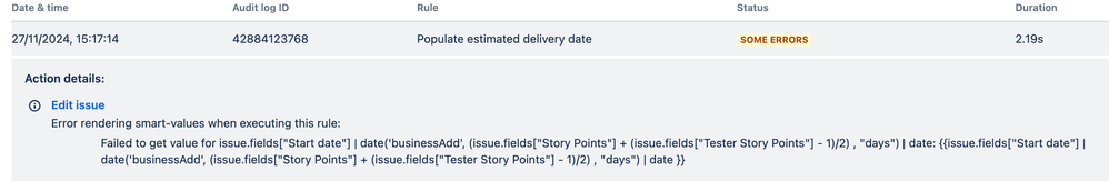

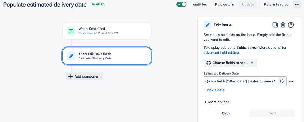

Hi, i have set up a date calculation based on input date and number fields which works in a workflow transition.
I am trying to run this same calculation on all historical tickets, and am therefore trying to a manual automation with JQL query.
The automation is failing with error:
Error rendering smart-values when executing this rule:
Failed to get value for issue.fields["Start date"] | date('businessAdd', (issue.fields["Story Points"] + (issue.fields["Tester Story Points"] - 1)/2) , "days") | date: {{issue.fields["Start date"] | date('businessAdd', (issue.fields["Story Points"] + (issue.fields["Tester Story Points"] - 1)/2) , "days") | date }}
Smart Value calculation:

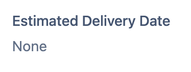

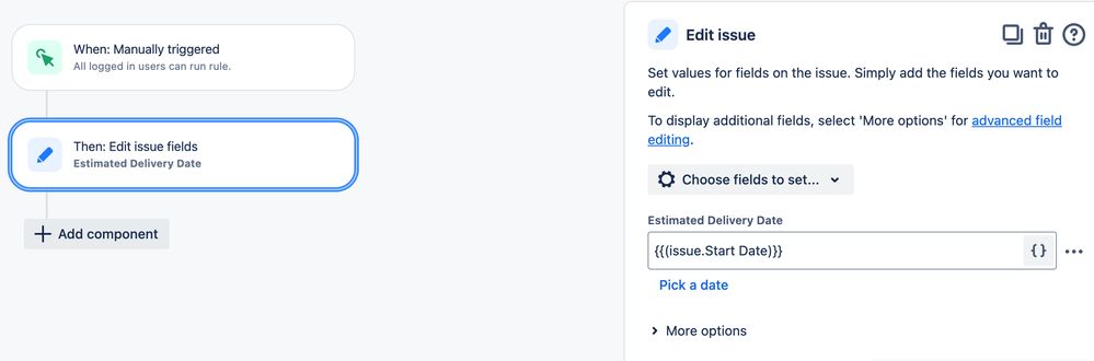

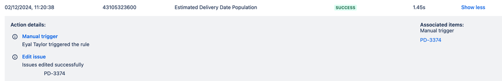

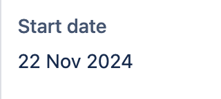

I have been trying to debug and test small changes. I am at a point where the automation rule is completing with success on a specific ticket where i am running the rule manually, and yet the custom field is not being populated with any value at all.
I have tried the following as a basis.
{{(issue.Start Date)}}
i.e to copy the date from custom field "Start Date" to custom field "Estimated Delivery Date"
The automation completed successfully, yet no value is set for the field. I have tried a few other formulas that complete successfully, but no value is set for the field.
Do you have any advice just to get the ball rolling where i might be going wrong?
December 2, 2024
First thing, please try to stay with one thread when responding.  That will help people reading this question in the future know if there are multiple solution approaches to try.  Thanks!
Your expression has unnecessary parentheses inside.  It should be like this, correcting the case of the smart value:
{{issue.Start date}}
Also note Start Date is one of those fields which can appear as text to a rule rather than as a date type.  And so if the above expression does not work, please use this to force the value to interpret correctly:
{{issue.Start date.toDate}}
